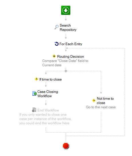

I think I have the basic workflow set up correctly:-)  I need to finish it off!  I'm trying to automate closing for a dept by searching a specific folder and looking for the document with the latest date.  I'm going to use the calculator on the "front end" (when the document is verified) to add this information.  This workflow will check those dates against today's date to see if enough time has past.
Please let me know if you need additional info - wf attached!

If you no longer need to compare the cases inside the workflow, then you can put your closing steps inside your For Each Entry activity and not need to save the values.
I've attached a bare-bones sample that you could use if you were just comparing the close date to the current date. If you wanted to only close one case per instance, then end the workflow after invoking your case closing one.

As you currently have your WF set up, you won't be storing any of the Field Values from the entries, as they will be overwritten when For Each Entry runs again. You'll need to create a token and then modify it inside the For Each Entry activity. You could create multi-value tokens to get all of the dates and IDs in order.
Harder to just get the oldest date however. I'll work on it and get back to you.

I got everything switched over:-)  That part is working.  You mentioned in the first post that I wouldn't be capturing anything in field values due the first part of set-up and you're absolutely right!!  I am finding the right values when I search the repository (currently 6 cases), but I need to have WF remember each of those Case Numbers and Close Dates for the next steps.  I like this new "token" option, but haven't used it much.  Any tips or other suggestion on  how to make this work?
I believe the easiest way to run this one is via timer "and" a search of the repository.  I'm looking for any case that is ready to close and need to get the case information.
replied on August 27, 2014
SUCCESS angelwinksmiley
