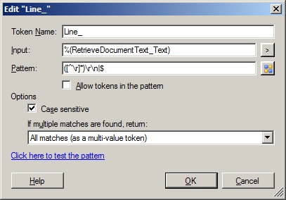

Given «P.O. Number» appears on the following line in your example, you can Retrieve Document Text then Pattern Matching the text as follows:
...then find a line in %(Line_) with the text "P.O. Number" whose next line pattern matches \d+.
To add more context hence prevent false positive, include the date to the right so the pattern may end up something like [\s|\t]+(\d+)[\s|\t]+\d\d\\\d\d\\\d\d[\s|\t]*
