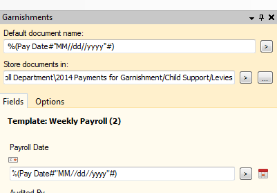

Okay, I am still learning so any help would be much appreciated.  Okay, I have a session that I'm trying to change the "Pay Date" from Dec 1, 2013 to 12/01/2013.  I have inserted a snip it of my task pane and my configuration pane.  I am using a OCR zone to read date.  Then I'm using a token dialog, but not working. When test after apply formatting, it works.   Should I be using a substitution process or pattern matching?  The two get me a little confused and when and when not to use.  I thought I could "add" a token with Token Dialog.  I am running QF 9.

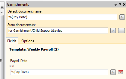

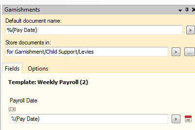

Thank you for prompt response.  Yes, I'm using Zone OCR to read date on sample sheet (see attached Garnishment Pay Date Zone PNG.  It seems QF did not automatically convert my date format from Jul 17, 2014 to 7/17/2014.  Please see Garnishment Revision Pane.  Also attached my task pane again to show that I do have my field with Zone OCR %(Pay Date).  Any other suggestions would be most helpful.

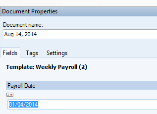

replied on August 22, 2014
Okay Miruna,  I just tried again.  Thought, "Hey it is going to work"  Please see attachments.  What happened?
Hm, the fact that the date gets converted to 1/4/2014 might indicate that Zone OCR is reading extra spaces or something else that's confusing date formatting. But it's hard to tell from screenshots. Could you have your reseller open a case with Tech Support and attach a sample image?

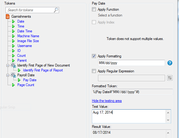

Kenneth, attached you will see how I tried to format token.  Test shows it is correct--worked.  Also attached is my token for Pay Date, unformatted.  When I left the token as %(Pay Date) it worked, but the date was reading wrong.  See my reply to Miruna.  I know it has to be something real simple I am overlooking.
