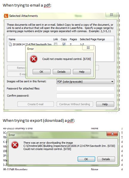

replied on June 15, 2016
Was upgraded to 10.1 last week and began having the issue.  Had it once before with LF 9.
Error - Could not create required control 6720 when trying to email or export a pdf from Laserfiche.
Our IT department (Jade) along with Molly from MCCI worked to repair the installation of LF 10.1.
They confirmed that a utility like CC Cleaner can unregister a dll, which can cause error 6720 and the inability to email or export (download in 10.1) pdfs.
Jade indicated that CC Cleaner had been run on the system the week before.
After the repair (no PC restart was required).  I was able to export and email pdfs.
Thanks Molly and Jade!
I hope someone else will find this helpful.
Error 6720.JPG (53.44 KB)
