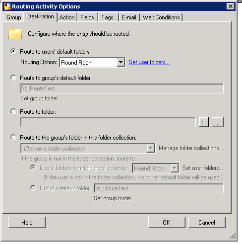

 I am trying to use the “Route Entry to Group” workflow activity using the round robin method for the destination. I am able to get this to work, but only if I manually set up each users default folder. How can I set this up so the round robin will send items to each user’s folder dynamically? In other words, if I add a new user to the active directory group, and they have a named user license allocated, will the round robin activity automatically build out their default folder? If I manually configure each individual user's default folder location, then the round robin route to group will work, if I do not  configure the users default folder to a static path, but use the token %(RouteEntrytoGroup_User_Account Name) then I get the error above. I must be missing something simple, any help would be appreciated.

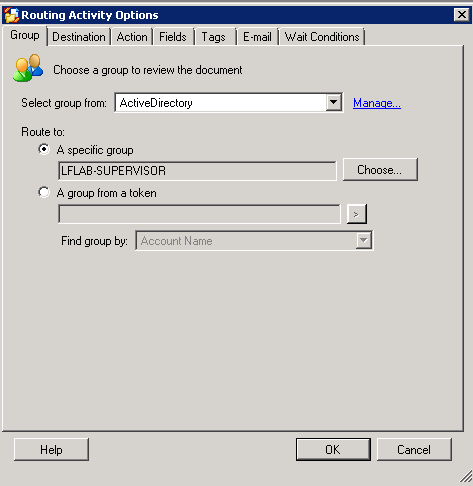

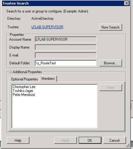

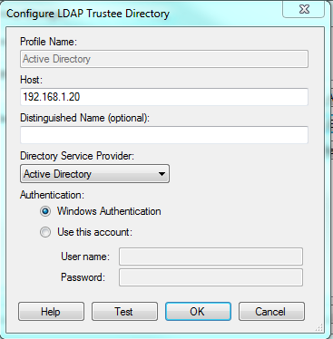

Here are some screenshots showing how the activity is currently configured. I have the default folder location set for the group but not for each individual user. One of the screenshots also shows how the trustee directory is configured, the distinguished name is not configured.
