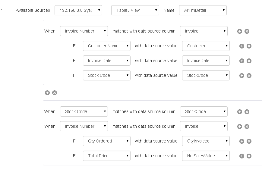

I have a table in a form that is populated from a lookup. The lookup value is based on an invoice number, which will then return all valid stock codes for that specific invoice number. This will then populate valid stock codes in the table's "Stock Code" drop down. Then, when the user selects one of the stock codes, it will automatically populate lookup data for "Qty Ordered" and "Total Price". Then, I have some script that calculates the unit price, and upon the user entering the "Qty Returned" value, the script with calculate a subtotal for each line item.
The lookup rules:
The form doing lookups:

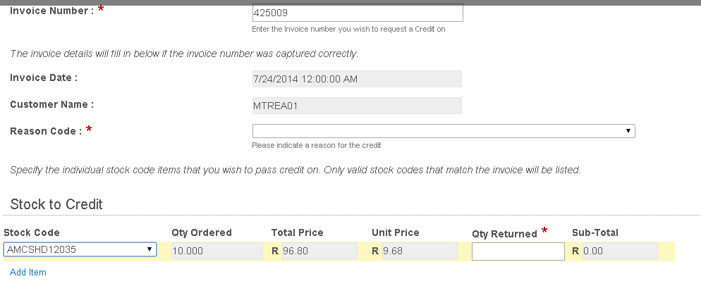

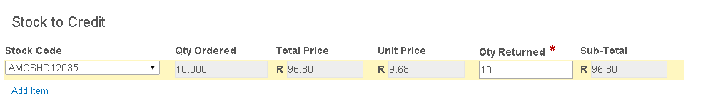

Add qty returned:

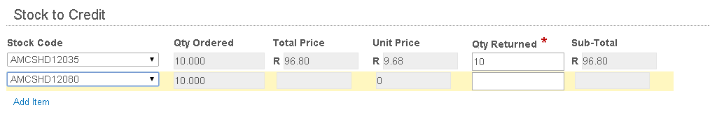

This all works wonderfully, until I add a new row. Then my table looks like this:
1. the extra row I add does not correctly perform the lookup as it did with the first row. The Total Price lookup value is missing, although the Qty Ordered lookup value is correct.
2. the table row formatting is broken. There's no currency symbol displayed for the Price columns and there's also no "X" button at the end of the row that allows you to remove the row.
