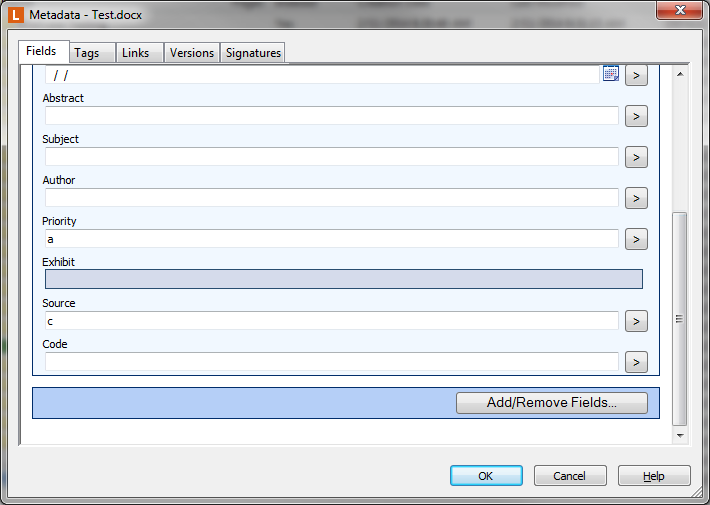

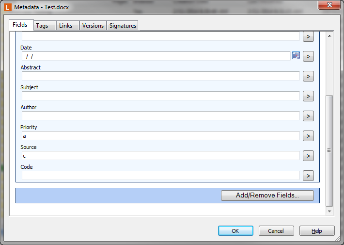

Can you make sure that the user does not have the "Manage Templates and Fields" privilege? Also make sure the user is not a member of any groups that have that privilege.
If the user does have the privilege, then even with being denied read rights on the field, they will see the following
but as long as the user doesn't have the privilege, then the field should not appear at all, as seen below
