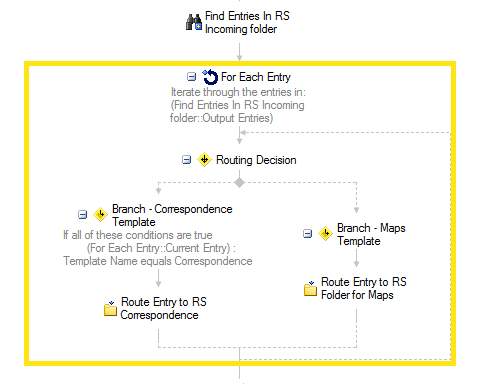

I've now rebuilt the WF based on your second paragraph, since (1) I don't have VS 9.2 only 9.1, and (2) all the documents are directly in the incoming scans folder and not in any subfolders.  How does it look now ? ...

If I'm understanding this correctly, you want to route based on the template on the documents not on the "RECORD SERIES - (a) Incoming Scans" folder? If that's the case, you should run the Routing Decision inside the For Each Entry and check on fields on the documents rather than the starting entry.

Miruna, I've rebuilt as you suggested.  I certainly see results, but it still didn't complete.  It found the 625 docs in the right folder, but didn't move them.  The error report says "Routing Decision" "The selected entry could not be found."  Can you tell why?

Did you set the Routing Decision to process the For Each Entry current entry?
replied on August 13, 2014
The only option it allows me to choose under For Each Entry activity is the Output Entries and there's no configuration choices under Routing Decision activity.
Bert meant the Route to Folder activity. Your screenshot covered the radio buttons on the Entry to Route panel in its properties.
Oh, then yes, the Route to Folder was set for Entry:  Current Entry.
