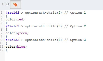

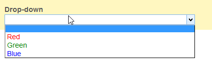

This what you're looking for?
Here's how I did it
Note: Take out the comments from the CSS section
replied on August 7, 2014 • Show version history
Good solution. I forgot about nth-child. It just occurred to me that if coloring individual options, remember to update your CSS if you ever change the values in the list or re-sort.
In that case, I'm thinking that if you are pulling values from the database and/or expect the values to move or change often you might have to resort to some magic strings.
I've updated the fiddle to demonstrate this.
All of the text, or just specific items? Either way, it's possible. Although with forms, you might have to do some jQuery contortions in order to access the elements after they've been rendered.
I threw together a quick fiddle with some examples.
