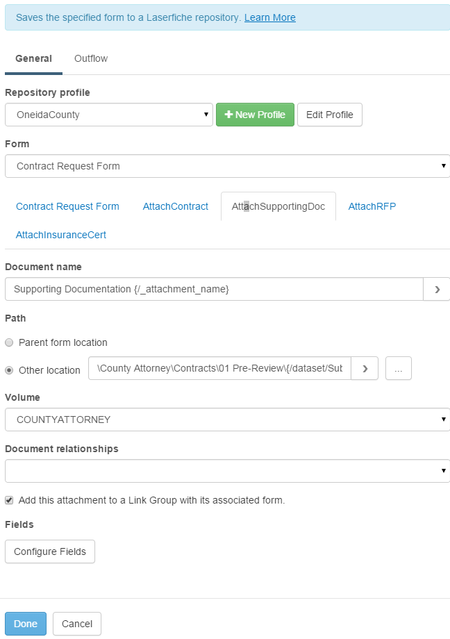

replied on August 6, 2014
Thanks Rob,
To create the subfolders for the documents being uploaded I configured them in the Forms process modeler for each upload.  The path I've built ends up creating subdirectories in the folder where the original form is saved.  See screen shot attached.  So my thought is if a file isn't uploaded the process modeler should ignore this part.  But maybe I'm wrong.
Thanks for your help.

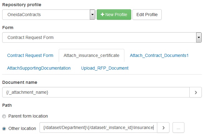

replied on August 5, 2014
Hey Sandy,
How exactly did you set up the process by which new folders are created?  Is this from the "Save to Repository" sevice task in the process modeler in Forms or did you have an accompanying workflow creating these folders?
If the answer is the process modeler in Forms, then you're definitely right.  The folders should not be created and this is quite a strange issue.
If the answer is that you have a workflow running and creating the folders in some way, then you may want to revisit the workflow to determine if things are set up correctly.
Either way, be sure to respond to this post and I'll take a deeper look once there's a bit more information.  If you could include a screenshot of the configuration of whatever you're using to create the folders (assuming there's no sensitive information displayed), that would likely help our troubleshooting efforts.

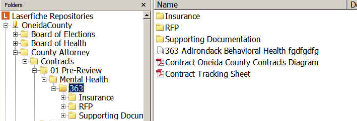

I'm looking at this issue again.  I am using the Forms processor to store the individual documents in specific folders.
This is the path:
\County Attorney\Contracts\01 Pre-Review\{/dataset/SubmittingDepartment}\{/dataset/_instance_id}\Supporting Documentation
And
\County Attorney\Contracts\01 Pre-Review\{/dataset/SubmittingDepartment}\{/dataset/_instance_id}\Insurance
And the folder structure in Laserfiche is like this.  So if an Insurance form isn't uploaded I don't want the folder to exist.
Thanks for your help!  Let me know if you have more questions.
