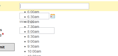

I can't seem to get this to work in Forms 9.2?
replied on February 17, 2015
This example works fine for me in the latest version of Forms 9.2.0.908. Can you clarify what aspect isn't working?
Off the top of my head, I'd suggest confirming that there are no typos in your Javascript and that you are properly referencing the external .js file. Using valid CSS will also make the fields appear like proper drop downs. Also make sure your fields are using the proper class names.
replied on February 17, 2015 • Show version history
I just copied and pasted the example above, and changed the external link to ours: http://website/forms/js/jquery.timepicker.js  and modified the .meeting input to .time input... And I changed it from .time input to .pto input and it works.. so I can't have that labeled as time I guess? Although the drop down boxes are not quite right?
The last part about getting the drop down to look correct is because you need to also use valid CSS.
Make sure you're referencing the external CSS file that comes with the timepicker or just copy the valid CSS from that file into the CSS field in Forms.
