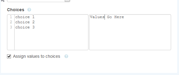

i meant, in the dropdown, when you select that field and select "edit" do you have values assigned for each item in the list?
replied on July 30, 2014
No, nothing.  It is my understanding that the value in the right hand side (in your printscreen) would replace the choice that was picked from the values in the left hand list.  That wouldn't accomplish what I need, at all.  It would, if I could tell it to place the new value in a completely different field (the one that would be in the follow-up form).  That would be perfect!
