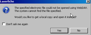

 So I did not have a specific error message, so I figured it would be best to ask this on here first.
We have a client who has a user with a machine that when they right click on a PDF and select "Opne -> View Electronic File" or "Open-> Edit Electronic File", the following error comes up:

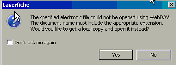

I figured since the document had ".PDF" at the end, maybe it needs to have it set with ".pdf"
After changing the name, the user gets this warning:

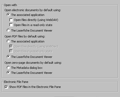

The users settings, are the same as the rest of the users in the department. They are:
While the client does have WebDAV enabled and the workstation does have the repository as a mapped drive, it should not be interfering with actions inside the Client application.

I notice your screenshot shows webdav disabled for other efile types but checked for pdfs. The options themselves are grayed out because the laserfiche document viewer is selected by default, but I'd bet they still take effect if you manually choose to open through the associated application (as is the case here). Have you tried changing the pdf option to associated application, unchecking the webdav option, and setting it back?
replied on July 29, 2014
I have tried that when I was connected to their machine. After setting it back, I actually found that if I enabled the WebDAV option a few minutes later, it would still have that sub-option selected. I will try and find out a status on this from the client. Thanks for the attention Justin.
replied on July 30, 2014
After adding in the string value registry entry, I tried this change again as the registry change itself had not worked. The client machine is now working just fine, I just needed to enable the setting to disable that grayed out option, then go back into that menu again to change it to what we actually want happening, and then it worked.
