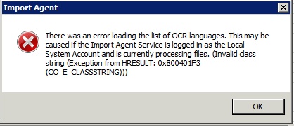

Also, here is perhaps another clue.  When I went to Profile/Options on the Import Agent, I got the following error message: "There was an error loading the list of OCR languages......"  (See attached screenshot for full text.)
APPROVED ANSWER
replied on July 28, 2014
You can repair the Import Agent installation from the Windows Control Panel or by running the Import Agent 8.1.1 installation again and choosing the "Repair" option.
After doing so, reconfigure the Import Agent service account to use the Windows AD account, ImportUser. Perhaps try placing that account in the Local Administrators group on that server.

replied on July 29, 2014
Alexander: I ran the repair on the Import Agent, and that fixed the error message about "Loading the list of OCR languages", but unfortunately it didn't resolve the original issue.
