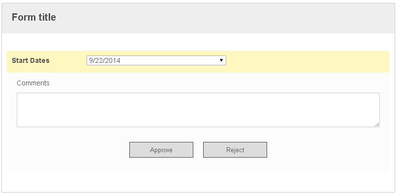

I tried your script and it worked fine for me. I picked 9/22/1014 in the initial form. Here's what the approver sees:
replied on July 28, 2014
Can you provide a screenshot of the output you are getting on the approval side that you are trying to avoid? It will help us all understand exactly what your problem is.
I would double check to see if you have the javascript code on the approval form, it potentially might be causing complications.
