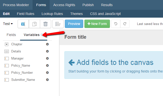

Ken's approach is one easy way to accomplish this. After copying the form you can add in any additional fields that the second user should fill out but that the first shouldn't see. Values from the original form will be passed into the corresponding fields on this secondary form, as these fields share the same variable. Then, as Ken mentioned, you can selectively mark some fields as read-only and leave others as fillable.
If you prefer to re-create the form but still pass values from the first form to the second, you can also start by creating a new form and drag the fields from the original form onto it using the "Variables" option.
Any field that could hold a value on the first form will be available in that list, and the values from the first form in the process will be passed along.
