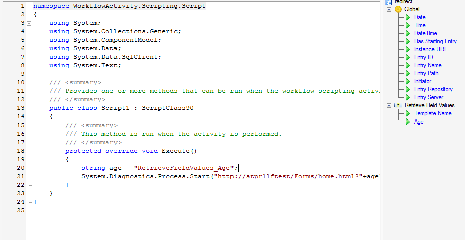

There's nowhere to edit the click function for the submit button. I tried changing it to the other option where it displays a thank you message and has a close button. I edited the button to redirect but there's no way to pull the information from the form to add to the url.
Right now I'm trying to use a workflow that uses a c# script to open the url with the value attached. I cant seem to get the value to be added to it.
It literally puts "RetrieveFieldValues_Age" into the url and thats what shows up.

Josh,
This may not help w/ your bigger task at hand but the reason your url is showing up with the literal "RetrieveFieldValues_Age" is because of how the variable is being set on line 20.
string age = "RetrieveFieldValues_Age";
This declares the value of age to be the literal string of whatever is between the " " instead of referencing the value of the variable named RetrieveFieldValues_Age.
What I assume you want is to retrieve the value of the Token, "Age", and append it to your url.
Try this:
Namespace WorkflowActivity.Scripting.Script
    '''<summary>
    '''Provides one or more methods that can be run when the workflow scripting activity is performed.
    '''</summary>
    Public Class Script1
        Inherits ScriptClass90
        '''<summary>
        '''This method is run when the activity is performed.
        '''</summary>
        Protected Overrides Sub Execute()
            Dim age as String
            age = GetTokenValue("Age")
            System.Diagnostics.Process.Start("http://test?"+age)
        End Sub
    End Class
End Namespace
Again, not sure this solves your larger issue but it will solve your url issue mentioned in your last comment.
