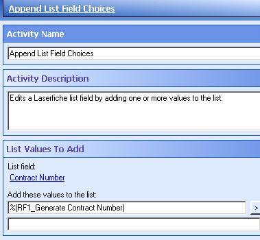

Can a field drop down list be sorted in ascending or descending when populated via the Append List Field Choice WF activity?
asked on July 21, 2014

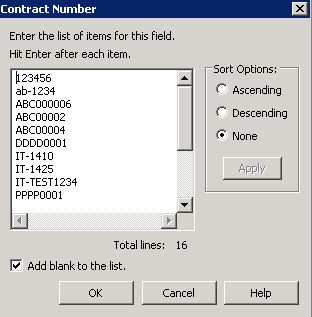

I'm running into an issue where I am populating a field drop down list using the Append List Field Choice wf activity. It seems that it won't take the value that is appended and include it as a sorted value... just adding it to the bottom of the list. I have selected the Ascending button multiple times and every time that I run the workflow to add a value, it gets set back to  None.
I'm not sure if this is a technical issue, non-supported functionality, or if I am missing some critical configuration point.

The list field values and their order (list position) is stored in the lup table in the database. The sort options that you see in the "edit list" dialog in the Laserfiche Administration Console performs a one time operation that will sort the current list values with the specified option.
When Workflow is used to append list field choices, it does just that (adds it to the bottom of the list).
You can manually go back into the Administration Console and re-sort the updated list values.
A possible alternative is to use an external table instead of a built-in Laserfiche list. Create an external table that you use Workflow to update with the new values. Then you can configure the field in the template to be a dynamic field (even if it's only one field) and map it to the external table and column specifying the ascending sort order.
