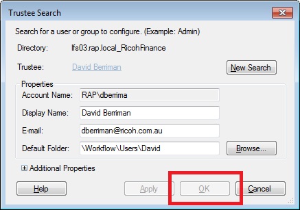

 We all of a sudden are having Workflows Terminate when the 'Route Entry to User' and 'Find User' activities are being used on one particular user. Looking at the messages on why it has Terminated 'No user was found'. I can't see how this user is any different to any other user. looking in the Admin Console.
So I thought I'd check these activities in the Workflow itself. I can find this User in the 'Route Entry to User' activity (along with his Workflow details like email, default folder, etc). But when I want to select him the 'Ok' button is greyed out?? See attachments. So something doesn't look right? No issues with any other user.
I tried deleting the user in the Admin Console and have re-added him again, but still no luck.

Just to clarify, the issue was Workflow thinking that the trustee was a group rather than a user. That is why you could find it when searching for trustees, but not when searching for users from the Find User activity.This was caused by the fact that there were 2 records in the account_cache table in the repository for the same account name, one saying it was a group, one saying it was a user.
Due to how the table is used, it's not likely it was the Admin console or Workflow generating the conflicting data, but it is a bug. We're still looking into how it happened.

replied on July 20, 2014
Thanks Chris, we are looking up Laserfiche type Trustee directory. I noticed that I can Search for the user in Tools | Configure Trustee Directories. But when we do the same search using an activity (like Find User or Route to User) this user cannot be found. I actually think there is a bug and am now talking to Tech Support.

Hi Chris and others,
I finally managed to solve the issue with LF Tech Support. It appears that either the Admin console OR Workflow Designer has created 2 records for this user in the Microsoft SQL database. So it sounds like a bug, I have left it with them to look for a patch. There may be others out there with the same problem. We are not sure what has caused it for only one user and not others. But this user does have a lot of workflows that route to him, therefore there could be other affected. Now it is a matter of going through these to double check.

replied on July 25, 2014
