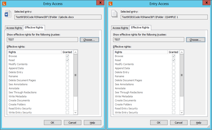

Thanks Connie. I tested in Laserfiche 9.0 and am needing a few more details regarding your configuration.
1. When logged in as a staff user, do they have the search results display settings configured to "Resolve shortcuts" or is that option disabled?
2. When performing just a text search, are they wanting the actual document to return in the search results or are they just wanting the shortcut to the document to return? (Or is that moot?)
3. If you look at the effective rights of the Word document and the image document, are there any differences for the staff user? See below regarding the information I'm seeking

3) Effective rights on both types of documents (Word and/or Images) are the same, granting all rights... browse, read, everything.
