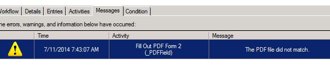

After workflow has completed attaching metadata to a PDF, and the file is inside a laserfiche repository, I am not able to attach metadata from a template. I keep getting an error of "Document Mismatch" all I can think of is that something is changing once the document is created with Forms being that I am trying to map the fields using the same PDF document I used in the inital workflow to create the document I need to add to. Any ideas or work arounds, or hotfix's?
replied on July 10, 2014
Where are you getting this error "Document Mismatch" from? Is it in workflow? I haven't run into any issues so far with that specific error messages but if you can give us some more context we would be happy to take a look at it. Maybe some screenshots will help?

I apologize, I mis worded the error. Its "The PDF file did not match".
This workflow will not enter information from the template into the document created by Forms. According to my Laserfiche vendor, this is a known issue and "should be" but not a guarantee that it will be fixed in the "next" release.

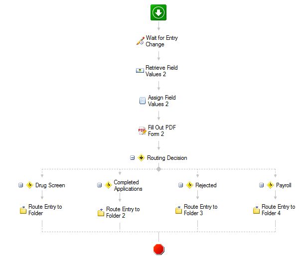

The workflow is attached.
The fields are being mapped properly. Workflow cannot insert that data back into the document. I'll give you a run through as to what I am doing.

I can't see the .wfi workflow file attached?
On another thought path. What if you create the information from the original PDF as a new token (assign token values) and try assigning that to the new PDF? I had a strange SQL issue once and this seemed to work around it.
Worth a try?
replied on July 14, 2014 • Show version history
take a look at this..
Administrator edit: removed attached file as it was giving away too much personal information.
what am I looking at?
Nothing, this stupid site will not let me show you the file you requested. It keeps removing it.
