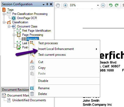

replied on April 25, 2019
Right-click on your OCR process and choose "Insert Local Enhancement" from the context menu:
replied on April 25, 2019 Show version history
Miruna,
Thank you. I'm not sure how I missed this during training.  I appreciate you!
