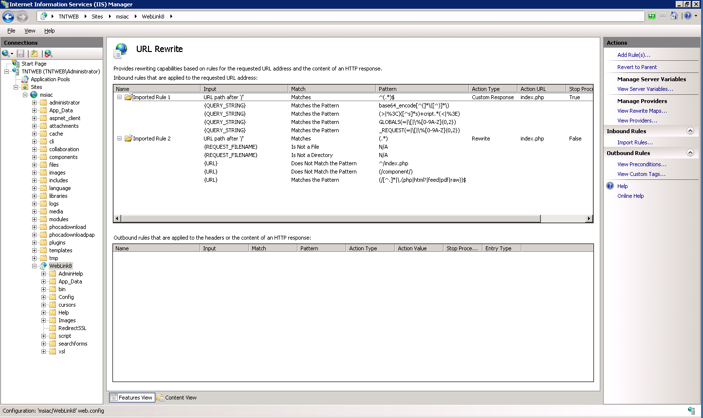

replied on July 7, 2014
Hi Wes,  I appreciate your attention to this.
I've attached a screenshot of my existing url_rewrite setting and tested the other link that you provided.  The link took me to the folder but failed on opening any link(s).
Michael
Unfortunately I am not at my computer but a quick glance at your screenshot leads me to believe that the WebLink application has inherited some rewrite rules which are not a part of WebLink and this is what is causing the problem.
My advice is to open the WebLink web.config file and make sure that the <rewrite> section does not contain what you see in IIS. If you happen to have another install of WebLink then compare the two web.config files (again, I would send you a sample but not at my computer).
Also, you may want to remove all of those rules (backup first) from IIS to see if that clears up the problem.
