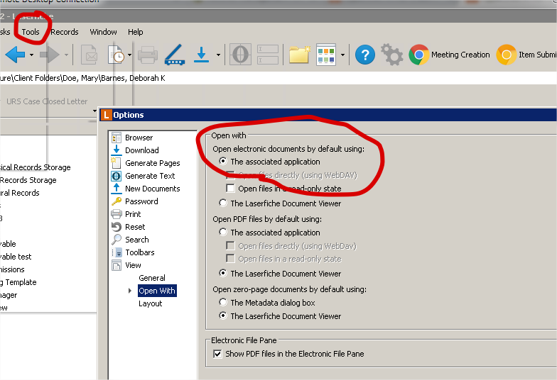

replied on July 21, 2016
replied on July 21, 2016 Show version history
We have once again reached out to Adobe to see if they have any response, as this issue is specific to the Adobe reader, for specific reader versions. I have tried a couple different methods of contacting them this time, so perhaps we will get a response.
replied on July 22, 2016
@Ryan,
Could you explain your screenshot a little more? Is that what I should have selected for my PDF's to automatically open as an electronic file?
Thanks

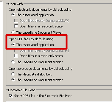

You'd actually want the next option in the list, open PDF's in the associated application.
Justin,
Will selecting that option open the PDF as an electronic document as default?
Yes, it will open PDFs with your default reader every time.

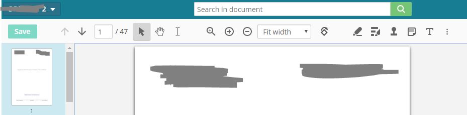

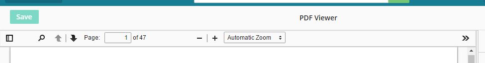

Perhaps im missing something here. When I click on a PDF I want the PDF to open as default the way I currently open one and then have to select 'View Electronic File'; it opens in a PDF viewer where i can use the internal links.
When I have done what you have done it has opened a new tab using an Adobe reader, which isn't what I want.
I want to view the PDF in a PDF viewer within the LF repository as default.
See the screen shots of how I get to the PDF Viewer which I want to open as default.
Your help is appreciated.

replied on July 26, 2016
If you want to open it by default in the Web Access native pdf viewer than you'd set that second option to 'the Laserfiche Document Viewer'. I thought you were saying that it wasn't showing up correctly in that view though?

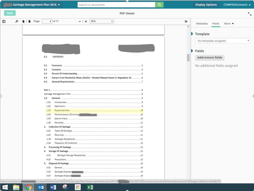

See attached screenshot of a PDF in the PDF Viewer/Electronic File view with yellow highlighted internal links that work. I want this as my default view for PDF's in the repository.
Let me know if I am doing something wrong here or completely misunderstanding.

1) It sounds like you cannot open the links from the default view because you are viewing the generated TIFF pages of the document, not the PDF pages in the embedded viewer, which is not related to the issue in this thread.
2) A workaround to the issue described in this thread is to open the document directly in the Adobe PDF viewer, not in the embedded viewer, which is the option that was suggested above by Justin
3) The issue in this thread does not apply to Web Access 10.1 embedded PDF viewer, since that uses different technology to embed the PDF than the desktop client
In your case, it sounds like you want to view the original PDF embedded in the document viewer in Web Access 10.1 for documents that also have TIFF image pages.
At this point, I am not aware of a way to default opening the embedded PDF viewer for documents with both TIFF pages and a PDF electronic file. I'll check in with the Web team to see if there is a way or if it can be added.
If you never need the TIFF pages, you could delete the generated pages and keep only the PDF, and choose not to generate them in the future. You would then go with the second radio button to open the PDF in the document viewer.

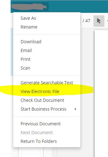

replied on August 3, 2016
Hi Christian,
I'm a QA engineer on the Web Access team. The best way to open the document viewer with the PDF pane loaded by default is to:
1. Right click on the PDF from the folder browser
2. Go to Open->Electronic File
3. Select either View or Edit in the dialog that appears
Currently in Web Access 10.1, there is no setting that loads displays the PDF pane by default when opening the standard way (double click or click on document name). We'll look into adding such an option for a future release.
