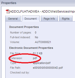

how can i know entry extension using SDK LFSO ? where i can pass entry id a long with function in sdk to retrieve entry extension
see the attached snapshot

thanks a lot i used this and it works fine.
appreciated
