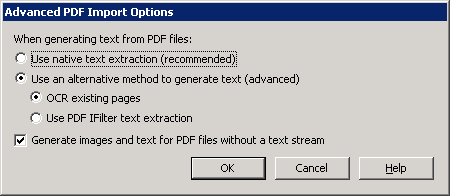

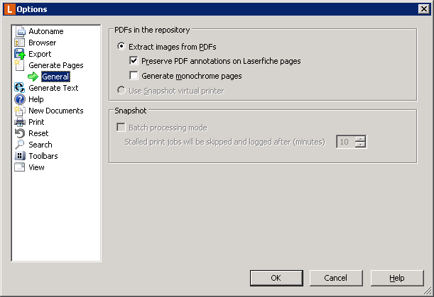

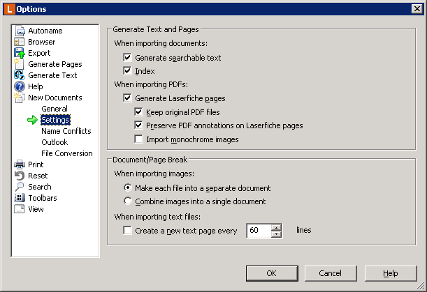

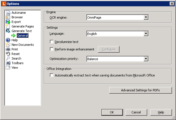

These are the Client settings I have:

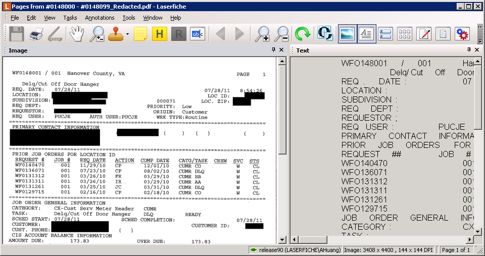

And this is what the document looks like in the Client document viewer after I import the PDF
This was using the 9.0.1.610 Client as well.
