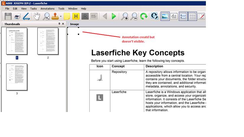

We are developing custom LF program which has includes a simple Annotation module.
The code runs good and creates the annotation, but the annotation is not visible on the page. (see below screen shot)
Here is the Annotation snippet,

The maximum stamp image size is 127kB (131070 bytes), the stamp you attached is slightly larger than that. I tried importing it myself and the server rejects it with "The bitmap data exceeds the maximum size"

Actually the code imports the BMP, but its not visible.  (see the attached)

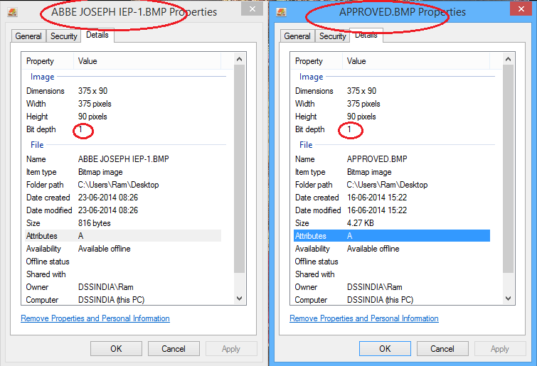

You can see the comparison here between the LF public stamp and my stamp details. (see attached please)

I am not sure about the bit depth in the properties, but when you open your image in MS Paint, the color pallet is still not monochrome.  You need to create a monochrome bmp file.
replied on June 23, 2014
Oh ok, Makes sense Bert.  I will try it.
Bert, Yes the monochrome works perfectly!.. Thank you so much for your help.
