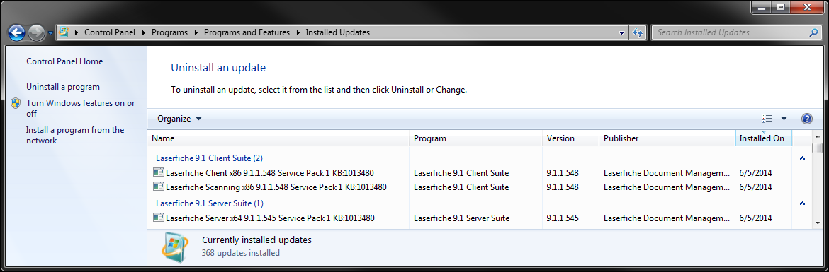

Typically when you see the options to repair, reinstall, or remove, that's an indication that the component is already installed. To verify that's the case, on the computers where you are running into this issue, can you go into Control Panel > Program and Features > View Installed Updates and confirm that they aren't currently installed? Below is a screenshot of what it would look like if the updates are already installed
If you see that the updates aren't actually installed on the machine then you may want to contact your Laserfiche reseller to open a support case. We'd be curious as to what happens if you chose an option like Repair or Reinstall.
