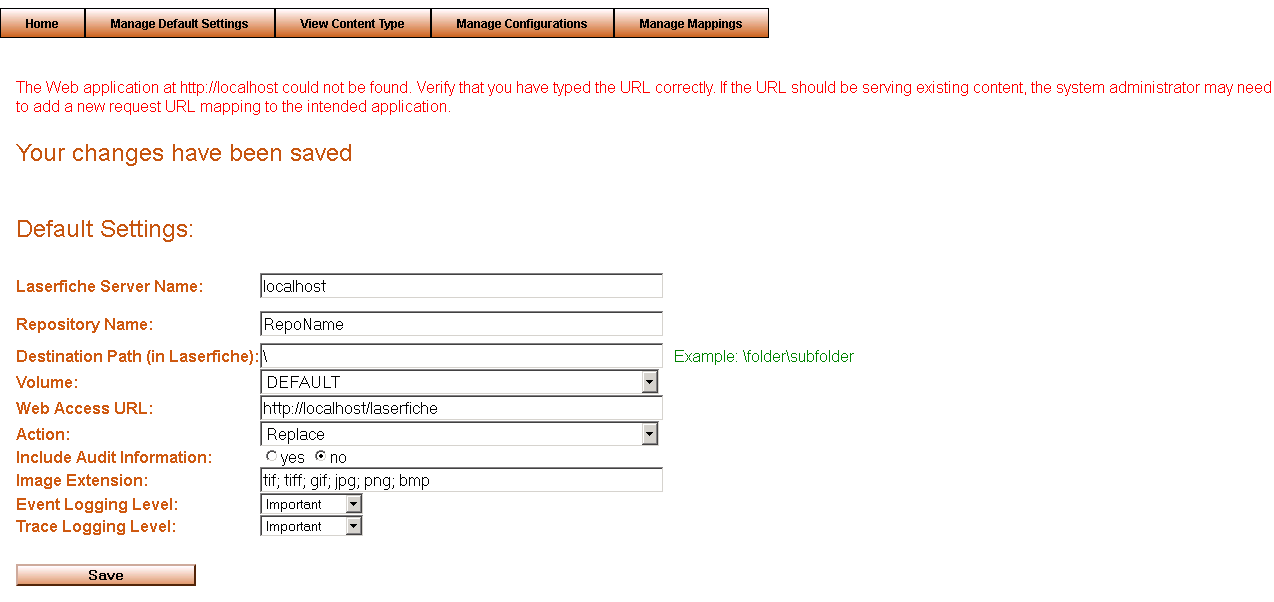

If your error looks like this:
Then the error is caused by issues communication with the SharePoint server, not Web Access.

Brianna,
Yes, I am getting similar error.
