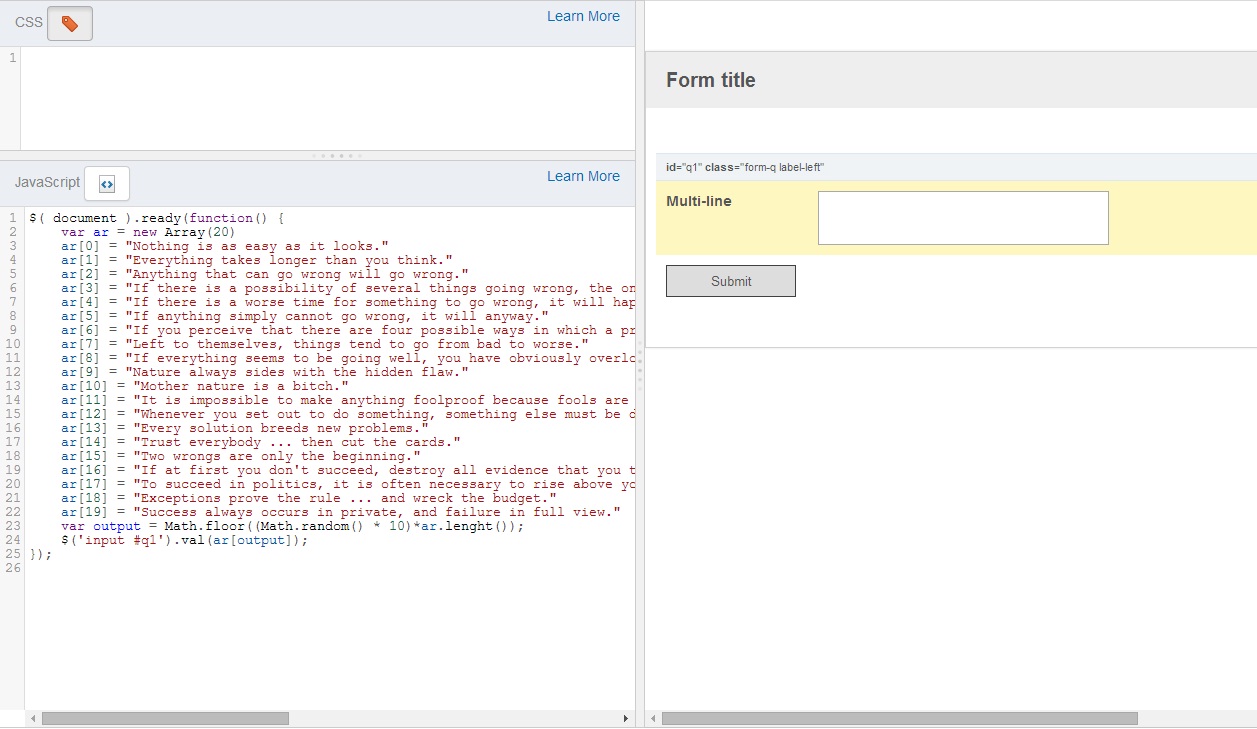

Still no results, I attatched a screen shot of the form. I was also wondering if we can input this into the custom html type field instead of a multi line or text box?
replied on June 6, 2014
Try fixing the length typo on line 23?

Have a look at this.
$( document ).ready(function() {
var ar = new Array(20);
    ar[0] = "Nothing is as easy as it looks.";
    //*snip*
    ar[19] = "Success always occurs in private, and failure in full view.";
    var output = Math.floor((Math.random() * 21)); //random number from 0 to 20
    $('input#q1').val(ar[output]); //no space between input and #q1
In your example, the selector still wasn't correct. On line 23 length had a typo, and .length() tells JavaScript to execute that function, not return the value. It should be just .length.
Here's a working fiddle.

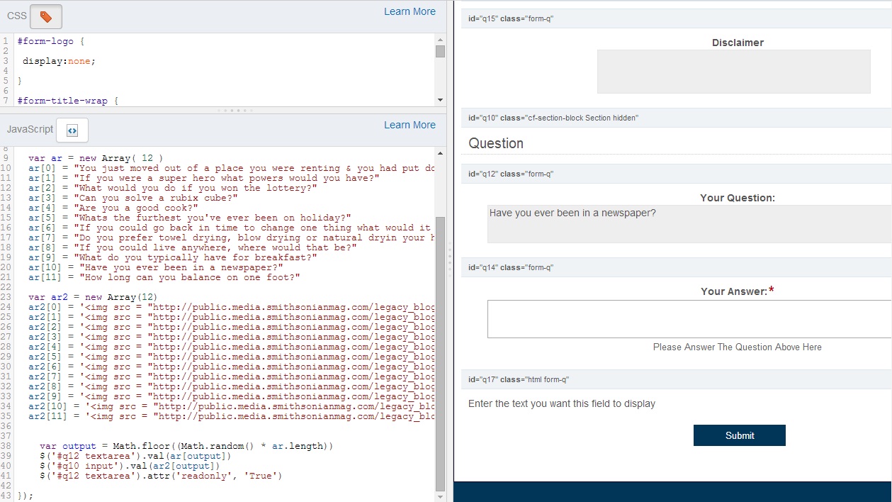

Okay, I'm sorry for dragging this out but I just keep running into questions.
Lets say I want to put a random image in dependent on which question is selected.
So I got the following:
  var ar = new Array( 12 )
  ar[0] = "You just moved out of a place you were renting & you had put down a deposit. How long does the landlord have to return your deposit?"
  ar[1] = "If you were a super hero what powers would you have?"
  ar[2] = "What would you do if you won the lottery?"
  ar[3] = "Can you solve a rubix cube?"
  ar[4] = "Are you a good cook?"
  ar[5] = "Whats the furthest you've ever been on holiday?"
  ar[6] = "If you could go back in time to change one thing what would it be?"
  ar[7] = "Do you prefer towel drying, blow drying or natural dryin your hair?"
  ar[8] = "If you could live anywhere, where would that be?"
  ar[9] = "What do you typically have for breakfast?"
  ar[10] = "Have you ever been in a newspaper?"
  ar[11] = "How long can you balance on one foot?"
  var ar2 = new Array( 12 )
  ar[0] = '<img src = "http://public.media.smithsonianmag.com/legacy_blog/smiley-face-2.jpg"'
  ar[1] = '<img src = "http://public.media.smithsonianmag.com/legacy_blog/smiley-face-2.jpg"'
  ar[2] = '<img src = "http://public.media.smithsonianmag.com/legacy_blog/smiley-face-2.jpg"'
  ar[3] = '<img src = "http://public.media.smithsonianmag.com/legacy_blog/smiley-face-2.jpg"'
  ar[4] = '<img src = "http://public.media.smithsonianmag.com/legacy_blog/smiley-face-2.jpg"'
  ar[5] = '<img src = "http://public.media.smithsonianmag.com/legacy_blog/smiley-face-2.jpg"'

replied on June 10, 2014 • Show version history
Does a text area pick up html code or does it just pick it up as another string?
I guess I'm not trying to randomize a picture and randomize the string displayed. I wanted to have the picture related to the string displayed. So if ar[2] = "anything that can grow will grow" I would have ar2[2] = some picture related to growing or if ar[5] = "If anything simply cannot go wrong it will anyways" ar2[5] = picture related to something bad happening and so on and so forth.
I attached a picture to show my setup. #q17 is the html input area.
You can't add images to fields that way. Instead you add a line like this after you generate the randomized text:
$(ar2[output]).insertAfter('#q10');

replied on June 6, 2014 • Show version history
The problem is probably your "#q1 input" selector.
Also note that you will always pull a quote from the first half of your array.  Use ar.length instead of 10 so that your range is automatically adjusted.
That code works for me. Check your selector on line 26 to make sure you're targeting the right field. If you want to populate a multi-line field, replace input with textarea in your selector.
Change the selector to just:
$('#q1').val(ar[output]);
The reason is that you are already telling it to get the element id #q1. Looking for input is redundant because there is supposed to only be one #q1. I think it works if you mix classes and element names.
Changing the selector to textarea still did not work either.
  • What type of field are you filling?
  • What is the identifier for the field, as shown on the CSS and JavaScript page in the preview?
