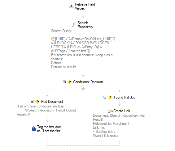

I've rewritten your workflow so it only makes one link per document. The way your workflow was designed, you change the target of the link every time a new document is moved into the folder. And there are a lot of unnecessary calls to the Laserfiche Server as links are created and deleted repeatedly.
I've modified the workflow as follows:
  • If the document is the first one with a given field value, we'll tag it as "I'm the first".
  • If there is a document tagged "I'm the first" with the same value as the starting entry, then we'll link the starting entry to that document.
  • The starting rule stays as it is.
So rather than searching for all documents, we're now only searching for that first document and only making one link.
replied on June 10, 2014
This way I am getting one to many connection.  This is not what we want.  We  already have this setup.    We need one to one connection.  For example if we had 4 file if I open any one of those file I should see link to each of other files.
With your suggested design we have one document that has all connections and others files have only one connection to that single file.
I the process I had we get one to one connection but for each document I get additional link (reverse link).   I was hoping to get rid of that extra link.   For example 4 document should give 3 link but I am getting 6 (2 for each link)  links.

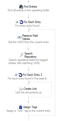

replied on June 17, 2014
I think I have a solution. Consider the following workflow. It goes through all of the entries in the operating folder, finds entries with the "LINK" tag with a matching UNID, links them, and then gives the current entry the "LINK" tag.
It's the tagging that prevents duplicates, so make sure the 'Search Repository' activity is returning tagged entries with a matching UNID. Your advanced search syntax will look something like this:
{[]:[UNID]="%(UNID)"} & ({LF:Tags="LINK"}) & {LF:LOOKIN="Repository\path\to\files"}
A couple of notes:
  • This workflow is designed to be run on a folder of documents that needs to be sorted out. It's not made to link incoming documents--you'll need to make some modifications to make that work (though the design would be very similar).
  • When you run it, it'll probably tax your system. I can't think of a way around having to run a search for every entry in the operating folder, but I tried to minimize other expensive calls.
  • This workflow does not take into consideration relationship direction. You didn't seem to care about it in your posts above, so I didn't worry about it either.
  • You're going to have to remove the "LINK" tag from all of your documents at the end, though you could tack that on to the end of the workflow pretty easily if that's a concern.
  • There may be a more efficient way to do this, but my way should work.
Thanks for getting back to me Zackary.  I was able to run your setup using the following search syntax adjustment:
{[]:[UNID]="%(RetrieveFieldValues_UNID)"} & ({LF:id > 0} - {LF:Tags="LINK"}) &{LF:LOOKIN="Rio\Transfer\FB_Conversion Workflow and QF Working Folder\WF Folders\01 Files will be processed for filing within Record series and Files with Errors will remain\Unprocessed from Forestry Appraisals and Environmental and Safety Management Systems folders"}
The result was similar to Miruna's workflow.   The links were one to many relationship.  For total of 3 file we had one master file with 2 connections to other attachments.  And attachments had on link to master file.
The way we needed was to create on to one relationship between all three file like Link group without duplicating each link.
If your were able to create one to one links between all files with the UNID, than I am missing something here, please send me summery of the activities.
On the other hand, I had one of our developer helping me out.  He was able to produce Link Group with the help of SDK.  I ran it on batch of 500 files it worked good.
Thanks for getting back to me.
