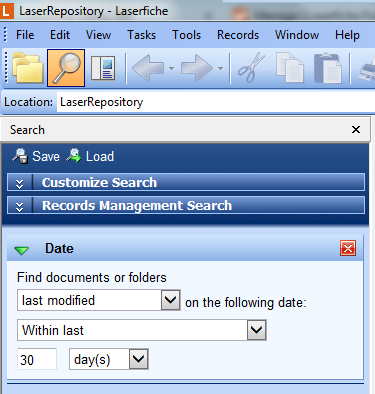

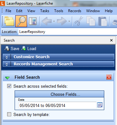

You can definitely do this using the Search Pane. You may need to tweak the configuration a little bit to get it in line of what you're looking for but it will look something like this:
You can also use the date search and find files that have been modified in the last 30 days
replied on June 5, 2014
Modified will not work the search needs to look at the Experation Date field and provide search results for entries Due to expire in 30 days.  Example:  If the search is conducted on 05-07-2014 the search should return entries that have a Field Value of 06-05-2014.  Once I get the syntax to work I will use the it to  run a workflow that will notify a user that a contract is due to expire in 30 days.  I hope this explains it better.
