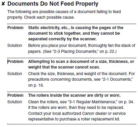

Here are the suggestions from the manual from the 4010C.
Also, what is your Page Separation mode set to?
