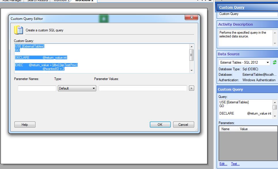

When I run this as a custom query in workflow and try to test, I'm getting "Incorrect syntax near GO twice.
replied on June 2, 2014
How is your data source set up?
I was actually asking if you're using the ODBC driver in the data source setup, but your screenshot answered the question (you are).
I think it will work as you want it if you remove both "GO".

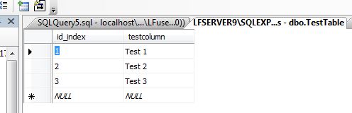

I created a new table:
I then created a simple stored procedure:
I then tested my stored procedure:
I then copied this to workflow:
then I clicked test to run:
So I appear to be getting the same error. I am assuming I'm calling the stored procedure incorrectly?
