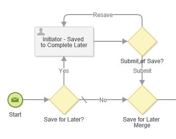

We built the functionality using the Process. See below:
We have a checkbox field on the bottom of the form that asks if they want to save it. In the process the "Save for Later?" gateway looks to see if that value is set to yes or not. If it is, then it assigns the form to the initiator. That will then allow it to show up as a task for that user.

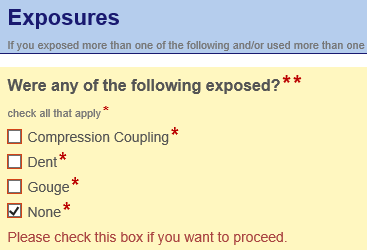

Issue I am running into, when the user is working on a saved form and is ready to submit, they uncheck "save for later" and this is happening to all checkbox and radio button fields:
