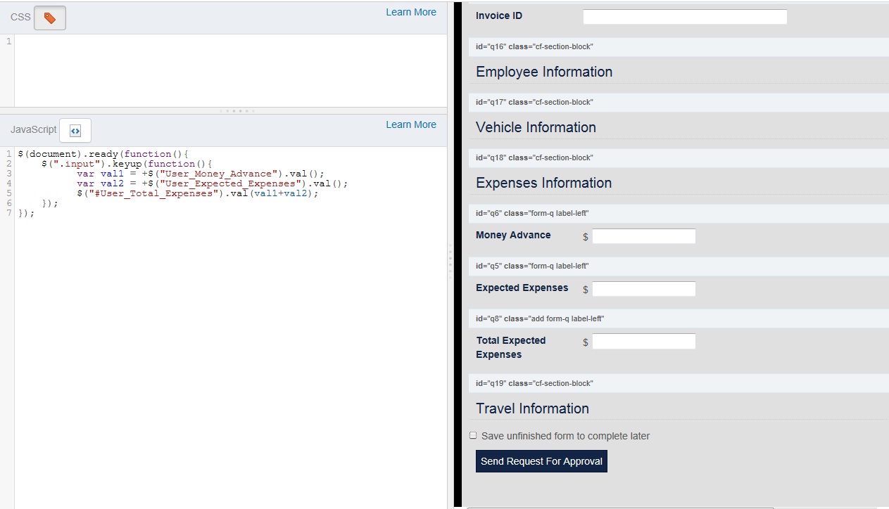

 Hello,
I have this form and want to take the value of Money Adavnce and subtract it from expected expenses and put the result in Total expected expenses. The code is what I tried. I am completely new to java and have no idea how to get to that result. Thanks for any help.

When you write JavaScript, it's important to tell the code when it should run. You'll usually want to put all of your code within a $(document).ready function, as shown in the code below. This ensures that your code will run after the page loads. Then, using the .blur() method, you can have a function run when the user leaves a field (I like this for calculations).
  $('#q1 input, #q2 input').blur(function () {
    $('#q3 input').val($('#q1 input').val() - $('#q2 input').val());
So, this code loads when the page is finished loading, and when the user leaves field 1 or field 2, the subtracted total is updated and placed in the field 3.

Okay, I read some of the example code and this is what I came up with but it isnt populating the total expenses box.
$('#q8 input').click( function () {
  var temp1 = Number($('#q6 input'))
  var temp2 = Number($('#q5 input'))
  $('#q8 input').val(temp1-temp2)
replied on May 30, 2014
Thank you very much for your help, that makes sense why it wasnt working because it wasnt loading when the document loaded. I appreciate your help.
