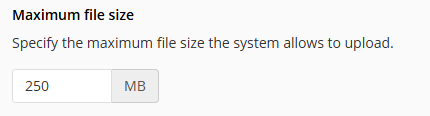

replied on August 6, 2025
Can anybody tell me where I can set this limit as I do not see it in the forms/formsConfig site.
replied on August 7, 2025
It's on Configuration site, Forms Server page:
