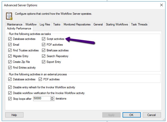

Try going into the WF Admin Console under Server Options, the Server Configuration node and open the Advanced Server Options dialog. In the Activity Performance tab, uncheck the box labeled "Script activities".

Making this change seems to have solved the initial problem, where scripts randomly hang up, so thank you Miruna. I am still interested in hearing why and how this makes a difference.

Reviving this thread, I have two situations where this exact same thing happens.  The workflow invokes a script, and then get hung up waiting for the script to finish.  When we restart the Workflow Server, all of the instances that are stalled then finish without issue.  But as they say, "that ain't no way to run a railroad."
It is as if the script completed, but Workflow never got the message.  The frequency is roughly 1 in 1000 WF instances.  Question:  in 10.3 / 10.4 this:
is no longer an option.  What was the role of that option, and has it been replaced?  Are there any good remedies to this problem?
Thanks -
replied on June 6, 2019
Scripts are run as separate tasks. If one stalls it could backlog the rest of them since there's a limited number of slots for tasks. They're supposed to time out after 30 seconds, but this is controlled by an option in Scripting Options. We'd have to look at what your settings are.
Restarting the Workflow Server clears out all running tasks, so the rest of the workflows can proceed.
Without knowing what the script is doing, it's not really possible to tell why it's hanging.
I'm not really sure what you mean about the Activity Performance tab. The checkbox is there in both 10.2 and 10.4 (there's no WF 10.3).

Thanks, Miruna -
I did find the dialog you posted by double clicking.  What is the difference in running a script as a task, vs. not running it as a task?  As far as the script goes, we did not change the time out default.  The script itself works with a value from a database, which will be either 7 or 8 characters long.  If it's 7 we zero fill it and then parse the date from a 01012019 format to 01/01/2019.  There is nothing here that I can see that would actually hang - it's just a bunch of independent If statements:
