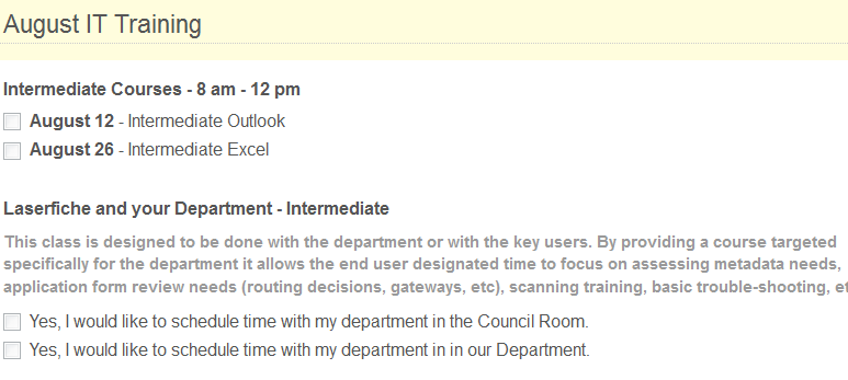

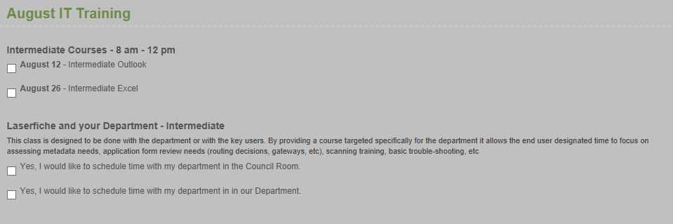

How can I get our external form to view as the internal version for text alignment? When using checkboxes, our text aligns too high. See attached images.

Yes, same theme however have not done any CSS on this form. Basic template at this point.
replied on May 27, 2014
What I see on my designer screen (internal view) is not what is seen on the published form (external form).
replied on May 27, 2014 Show version history
I think you are looking at the version in the "Edit" tab, versus if you were to hit the preview button, am I correct?
The Edit area will not look like the published version, that's why you are given the "Preview" button, to allow you to see how it will look to the users.

I had previously adjusted the text to see if that worked however that was not successful. Yes, I am aware the preview versus edit are not exact replicas however I have not had this much variation in views.
If I were to CSS the text, what would you suggest? Appreciate your help!
Without working with your form, I'm not really sure what the issue is. You could try adding the following CSS rule to the CSS and JavaScript page.
.form-option-label {vertical-align:middle;}
