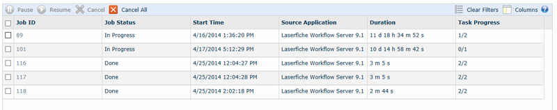

Is there a way to see older jobs? We are looking to see if there are any jobs still in progress, no matter how old. Last we checked there was jobs running for over 11 days and we were trying to find what happened to those jobs, did they finish or are they still active. The graphic interface was not showing all job history.

Let me clarify on the 3 days point: DCC will show all jobs submitted in the last 3 days, as well as all jobs that are currently running, regardless of the age. Note, however, that after about 3 days the job will fail immediately, as its access token for the Laserfiche server will have expired.

Our jobs are running for over 10 days though.
replied on May 30, 2014
Both of those jobs are definitely indicative of DCC problems. The first one is almost certainly related to an OCR issue that we are aware of and hope to have a fix for in the next release. It should not come up very often, as it is related to OCR itself failing and taking too long to process an image. I'm not sure what is going on with the second job, though. Can you give more details on your setup? How many machines do you have, and what kind of workload are you putting the cluster under? Also, if you could attach the event logs from the scheduler and an affected worker, that would be very helpful in tracking this issue down (note that you would have to save the event logs shortly after the problem occurs, since they are overwritten fairly quickly). It might be useful to open a support case so that we can gather some more information.
