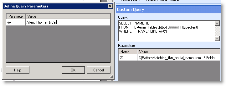

I am attempting to query a SQL table using Workflow 9.1.1 custom query activity.  It is using a partial folder name gathered from a pattern matching token. When I test the query in the designer, using the same partial folder name in the parameter value field, it results in "0 row(s) affected."

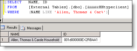

I've run the same query in the SQL Server Managment Studio with success.  I've attached screenshots of both results.
Is there an issue with the syntax in Workflow as compared to the SSMS syntax?

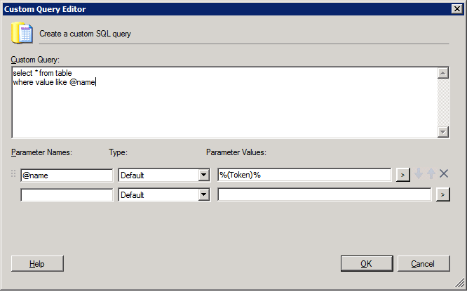

The following query works for me for a direct connection to SQL. Can you post a screenshot of your query and parameter setup?

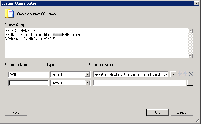

replied on May 23, 2014
Here is my query:
I'm using the % as a wildcard to find the Name that starts with my pattern match.
replied on May 23, 2014 Show version history
Can you take out the quotes around @NN? And move the % into the parameter definition right after the token?
Miruna,
You have done it!  That works now.  Thank you very much!

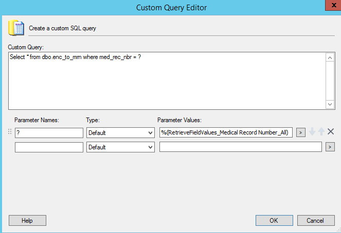

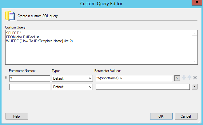

Thank you everyone for providing detailed info on this post - I really did try to follow it as it's exactly what I'm looking for.  Mine 'should' be simple...
Writing the custom query SQL 2014/LF WF 9.2.0.167.  It's fine directly run in the database, but doesn't like the ? in LF so I've tried naming the parameter, putting quotes (single and double around it).  The results will always be numeric - the hints listed above and that's not working.
Additionally, I do need to add this to the query: ORDER BY modify_timestamp DESC
I took it off while trying to get the first part working.  I'm in need of the most recent result in the table.
Thanks for your help!

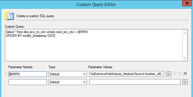

UPDATE: I figured it out :-)
Here's a screenshot of my answer in hopes it helps someone else!  It really was simple - using the @ option instead of ?!!
