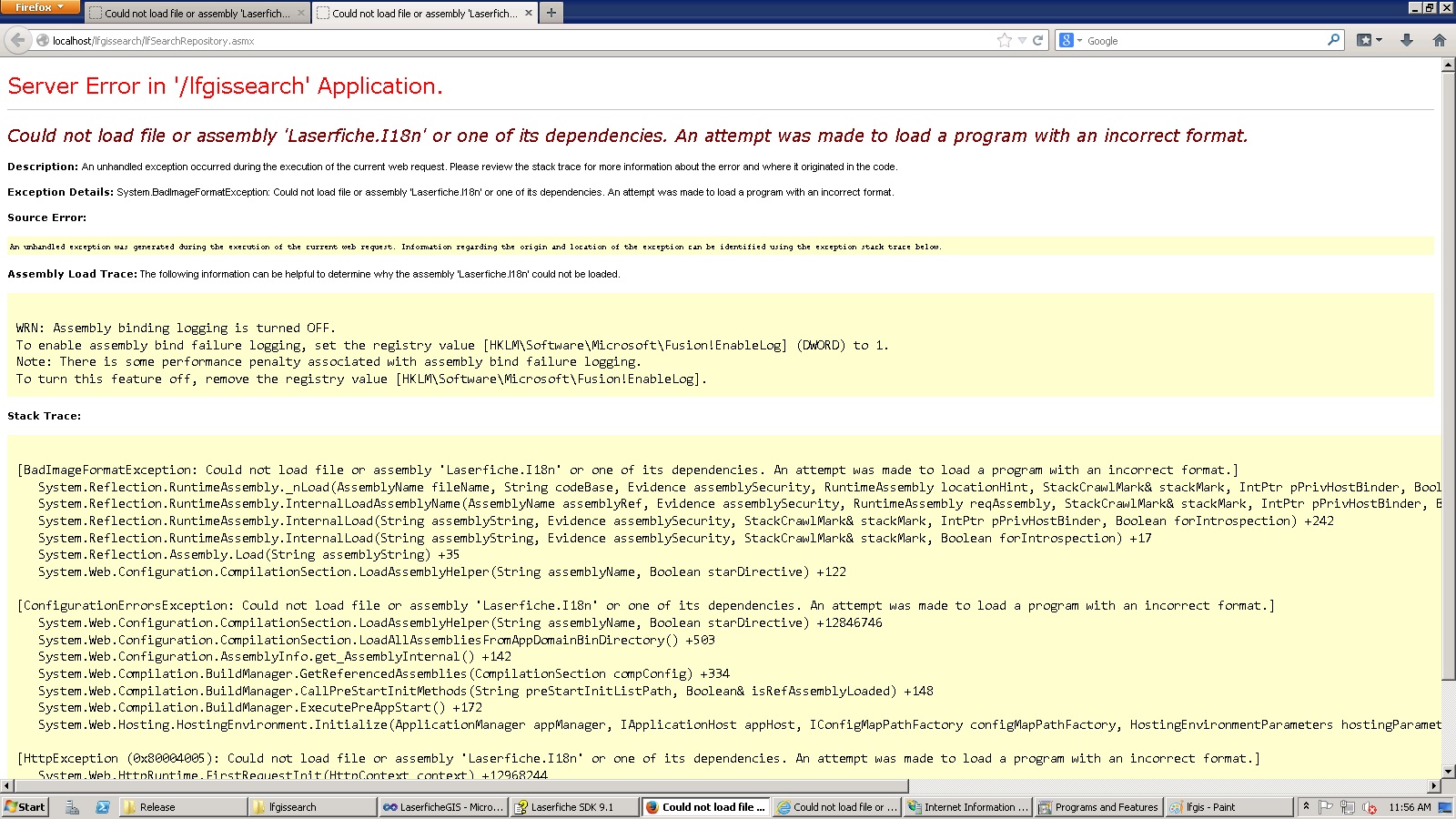

So I have created Web Setup Project with x64 platform. Setup is getting created successfully as well as application is getting installed successfully. Now I am executing my web service from IIS and it gives me DLL dependenci error: "Could not load file or assembly 'Laserfiche.I18n' or one of its dependencies. An attempt was made to load a program with an incorrect format."

The files Sheldon references are located in the GAC. They are actually included in any installation package that installs Repository Access, as they are RA dependencies - it's just that there was an unrelated hotfix recently and the Web Administration Console was the first RA product to have an update since then.
The SDK runtime files DEFINITELY include this DLL, or else RA coding would NEVER work. However, these files depend on the VC11 runtime which is not included in the SDK runtime installation - make sure that is installed. The issue generally is one of arch - while Repository Access itself is arch independent, these dependency files are not. If you are adding merge modules manually, please ensure you are including both the x86 and x64 msm's of RA. You'll also need to include both archs of dependency msm's like ICU (ICUSxS only is the arch of the installation though). These files also depend, as noted above, on the VC11 runtime so make sure both archs of that are present too if this might be run in an x86 process.

Thanks Justin,
I have downloaded and installed new x64 version of VC11 on my server. My problem is resolved and I can able to execute my web service.

Hi Justin,
Installing VC11 on the web server has resolved my issue. Thanks for the help!
