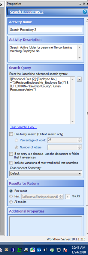

Second, it searches within a specific location in our repository for folders or documents that have the same employee ID. We have it set to return the first result, which should be the main employee folder.
Here are the properties for that search:

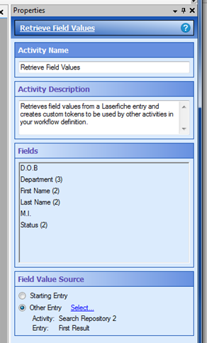

Next we are retrieving field values from the folder found in the 2nd search.
Then we are routing the entry to the first result path and applying the retrieved field values to the new entry.

Your search is looking through all the entries (folders and documents) under \Active. So you're getting the employee folder and all its documents. The order is non-deterministic, so your first result could be the employee folder or it could be one of the documents. If it's the folder, then the entry path ends with \Department. If it's a document, then entry path contains the employee folder too.
If you add a &{LF:Name="*", Type="F"} criterion to your search, it will return only folders.
