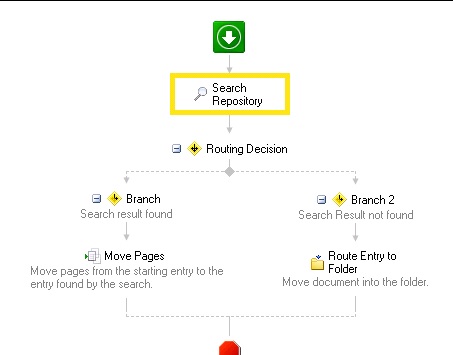

You would scan or import the document Court Docs.  When that happens the Workflow triggers.  It runs the above search using the Court Docs name and searches the 11-1-11111111 folder for it.  Then there will be a decision.  See the diagram above.  If it find the document, it moves the pages.  If it does not, simply move the document.

Chris's option looks perfect for what you're looking to do... should read something like this:
Search for Case #
If Result count of Search for Case # = 1
Search for Document named "COURT DOCS" inside of "Search for Case #_FirstResult"
If Result count of search for "COURT DOCS" = 1
use "move pages" activity to combine with new "COURT DOCS"
Is Result count of search for "COURT DOCS" = 0
use "Route Entry to Folder" to simply put the new "COURT DOCS" in the folder.
