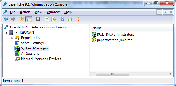

replied on May 16, 2014
If a user isn't a system manager, they won't see a number of items, including any of the items in Berts screenshot aside from the Repositories node itself and as well as the Named User checkboxes, so this is likely the issue.
Users who are local admins on the Laserfiche Server machine will automatically be system managers, otherwise they can be added manually as Bert shows. For Web Admin you need to manually log in as a system manager so it's clear that's what is going on, but in desktop Admin it's an automatic process so it's either there or it's not.

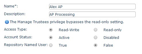

replied on May 15, 2014
I have Web Admin into Laserfiche 9.1.1 on a network server that is off our domain.
The user details appear as:
