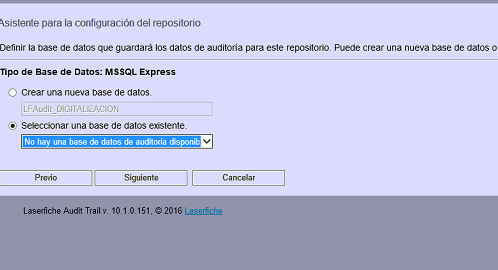

i have same issue, in audittrail 10.1
Ocurrió un error mientras se aplicaban sus cambios.    at WebAuditConfig.ConfigurationService.AddSearchableData
(RangeType type, Object[] parameters)
   at WebAuditConfig.ConfigurationService.AddRepositoryWizardData(RepositoryWizardInfo repositoryWizardInfo)
the database user has all permissions, well I can not deploy the database list.

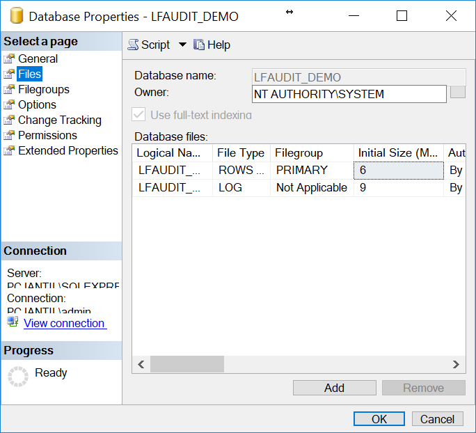

I guess there´s a better way to do this without changing the default account the Audit Trail service is running under: change the owner of the target AuditTrail database to the same account that Audit Trail service is running under. In the case of a default installation, that is local system account. So, change the owner of the audit DB from whatever it is to "NT AUTHORITY\SYSTEM"  before running the repository wizard in Audit Trail config.
This is fairly easy to do in SSMS (Management Studio). Just go to Properties in the desired Audit DB and once there, go to the "Files" page and change owner from there. Ok it and run the Audit Trail repository wizard now. It should work like a charm.
