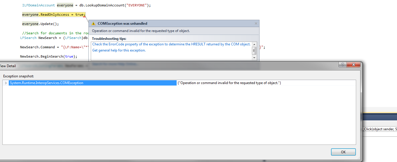

I set out to do this and I am being explicitly told by the compiler that I can not set ReadOnlyAccess equal to "true" for Domain Users.
The exact statement is
"Operation or command invalid for the requested type of object [ILFDomainAccount]"
It does support setting ReadOnlyAccess equal to "true" for an ILFTrustee object.
If Everyone is not a Trustee how is it possible to set Everyone to read only using the SDK?
Entire Code
            ILFDomainAccount everyone = db.LookupDomainAccount("EVERYONE");
            everyone.ReadOnlyAccess = true;
            everyone.Update();

The ability to set the Everyone group to read only was only added in Laserfiche 9.0.1. You aren't going to be able to do it through earlier versions of LFSO or on earlier versions of the Laserfiche Server.
replied on May 14, 2014
I'm not sure what's going on, as it works for me. ReadOnlyAccess is a settable property of the ILFDomainAccount interface. Which version of LFSO are you using?
replied on May 15, 2014
LFSO80Lib
It only happens when I use an ILFDomainAccount object.
I haven't tried LFSO 8.0 but I suggest using a newer version of LFSO. Newer versions of LFSO can connect to older versions of the server.
replied on May 16, 2014 • Show version history
This got me interested, so I started to look into it as well.  What I have found is that the problem (for me) only hits when I try to set the EVERYONE.ReadOnlyAccess = True.  If I set it False, it does not throw an error or if I set it false on other users/groups it does not error.
Also note that I tried it with LFSO8.0 and LFSO8.3 with the same results for both.
