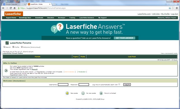

Just a heads up, this link:
https://support.laserfiche.com/Forums/login.php?redirect=viewtopic.php&t=17694
redirects to a page that simply displays "241.903"
replied on July 17, 2014
To view pages on the old forum, you may have to log out of the support site first. Then, visiting the old forums should prompt you to log in and you should be able to access that post.
Hi Brianna -
After trying all kinds of logins and logouts, I can actually log Into the forums page, but it is collapsed and will not expand any of the threads.
Thanks for letting us know, Bill. We're looking into it.
replied on July 21, 2014
The old forums should be back up. You may need to clear your support site cookies in order to access them.
