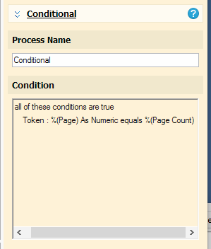

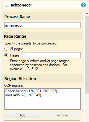

I have set up the conditional statement - however it appears that I have something incorrect
The zone ocr ocr's the first page of the document rather than the last page --  in the zone ocr if I use %(page Count) zone ocr goes back to page 1.
I am missing something simple -- please help  --  see attached screen shots

replied on March 24, 2015
Hey Adam,
The link to the ECM Blog post has been restored. Thanks for bringing it to our attention! As for your session, it looks like your Zone OCR process is set to only process page 1 of the document; try changing the setting to 'All pages'. Also, make sure post-processing is set to run 'after a document is processed, but before being sent to the repository'. If the issue persists, or you have any other questions just let me know!
thanks for the link restore--  I have tried all pages same results also have the post processing set to run after a document is processed, but before being sent to repository.
I have submitted a support case  -- I will update with the results  (I have sent support the session)
