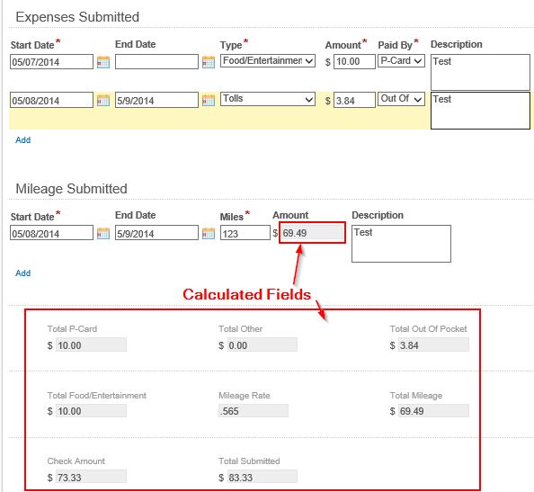

I appreciate your help with this.  I've attached the forms javascript and a screenshot of the pertinent portion of the form.
